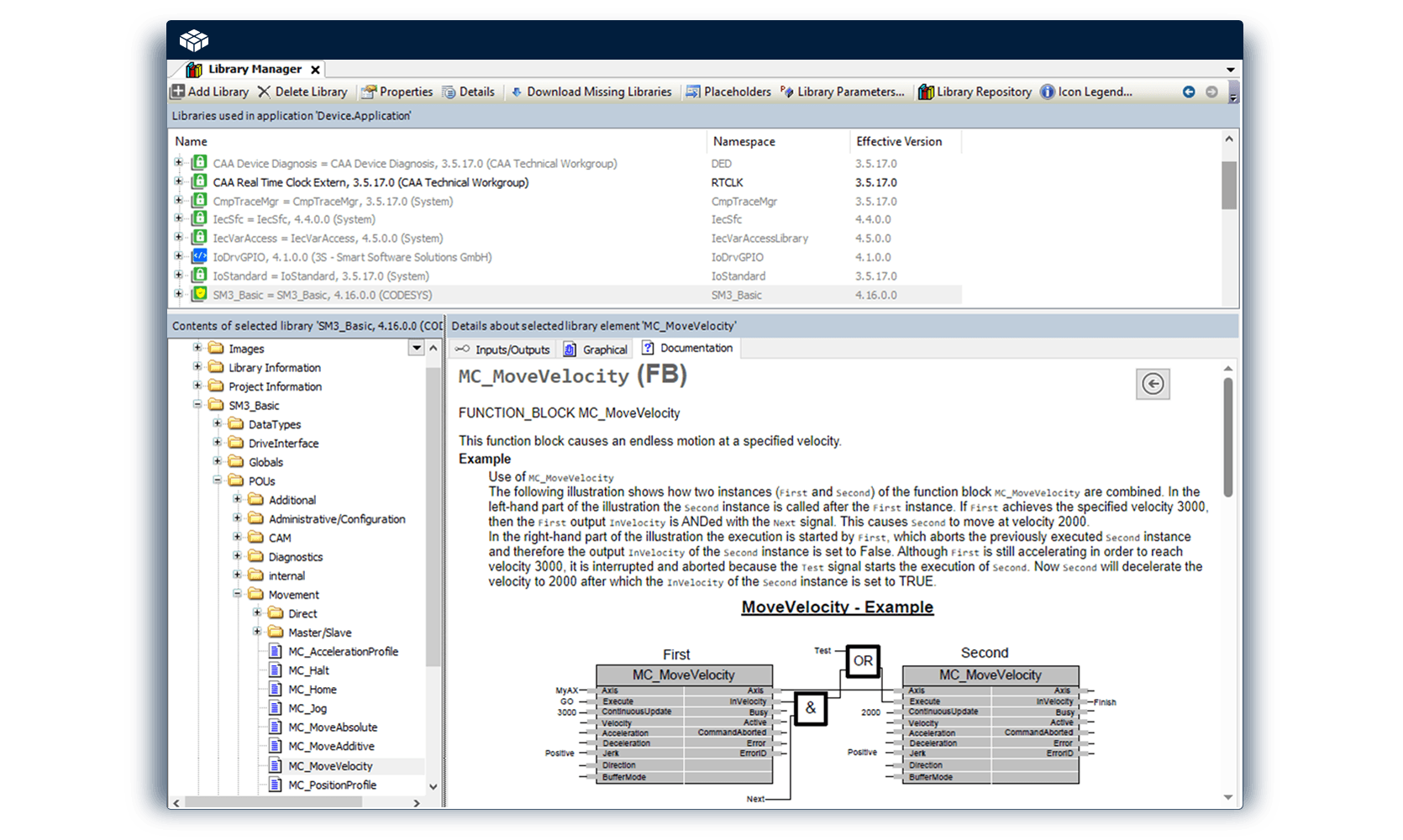

With CODESYS libraries, you can simplify access to such functions for your customers or package additional benefits in function blocks.
Manufacturer-specific libraries
As a device manufacturer, you have equipped your CODESYS-compatible device with the desired functions - either by adding runtime components from the CODESYS portfolio or functions that you have integrated into the runtime system yourself. With CODESYS libraries, you can simplify access to such functions for your customers or package additional benefits in function blocks. Everything you need is available in the CODESYS Development System and can be used free of charge:
Typical use cases
  • Encapsulation of complex functions (e.g. realized with object-oriented programming)
  • Simplified access to special functions of the runtime system / device, such as I/O systems
  • Specific functions for special sectors, customer groups, or applications
  • Visualizations for function modules that simplify commissioning
  • You own communication protocols via standard interfaces
Advantages of your own libraries
  • Create added value for your specific system!
  • Promote customer loyalty with useful additional functions and simplifications!
  • Package your application know-how and market it directly!

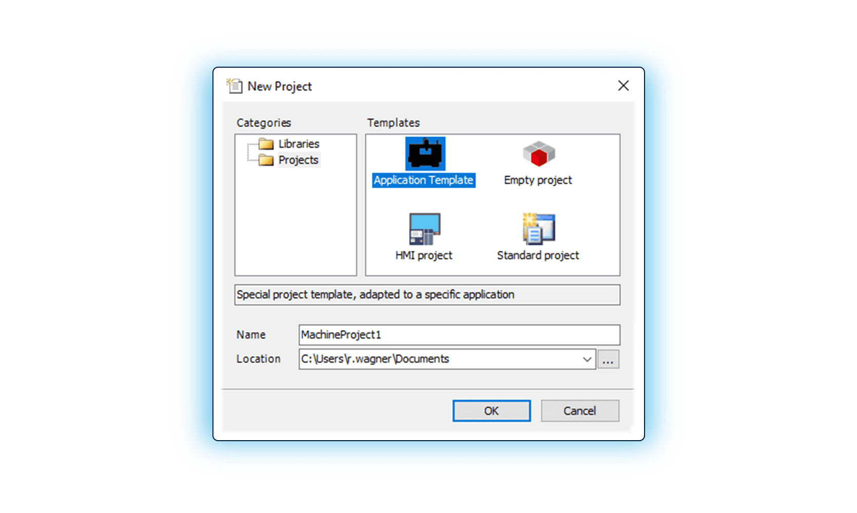

Create templates that make it easier for your customers to get started with a new CODESYS project. This option is an integrated feature of the CODESYS Development System.
Application templates
Do you already know from experience with your customers how they typically implement control applications and which components must always be included in a project? Then create templates that make it easier for your customers to get started with a new CODESYS project. The ability to do this is an integrated feature of the CODESYS Development System.
Properties
  • Templates for new projects and libraries possible
  • Storage of templates in their own categories
  • Open template projects with any predefined CODESYS projects, e.g. with integrated program blocks, variable lists, visualizations, etc.
Advantages of your own templates
  • Accelerate the start of application development!
  • Create added value for customers of your specific system!

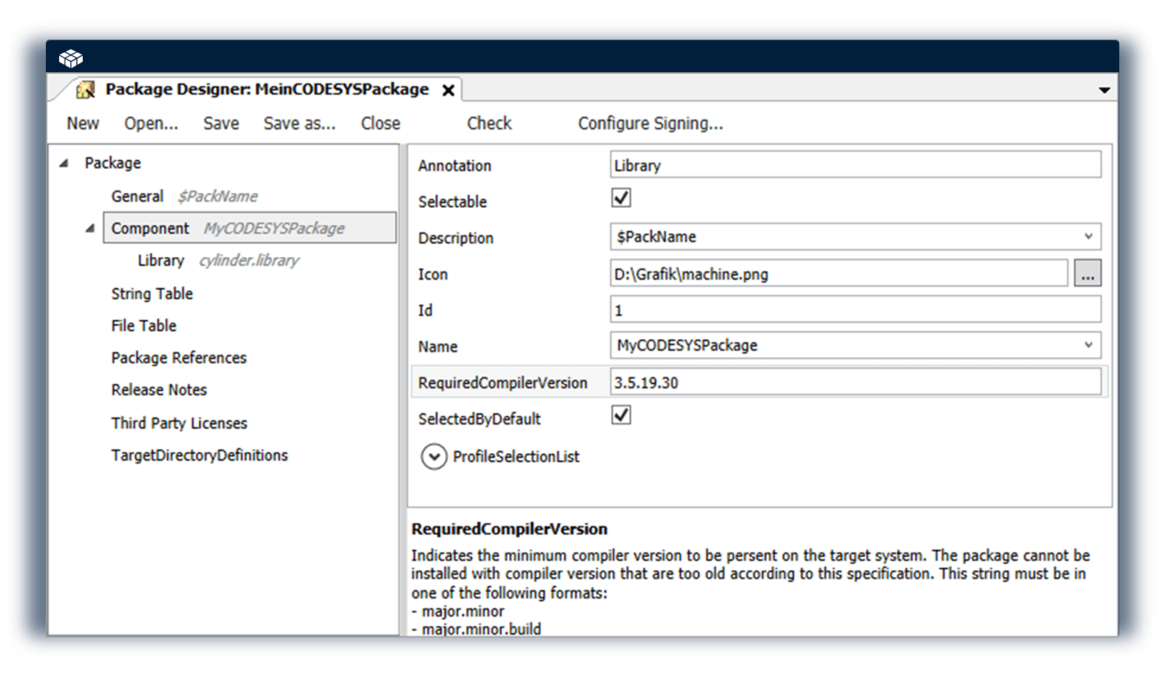

CODESYS packages are compilations of information that are used/required or may be useful in the CODESYS Development System. As a device manufacturer, you typically pack the specific device description for your CODESYS-compatible controller, including the associated libraries, into such a package. You can also store additional information and commands. Again, the aim is to provide your customer with optimum support.
With the free Package Designer, you can create and test your special CODESYS packages directly in the CODESYS Development System, including license agreements for your software.
Overview of possible elements (extract):
  • Any files, e.g. auxiliary information or data sheets in PDF format
  • Device descriptions, e.g. for the control unit itself or optional I/Os, fieldbus devices, etc.
  • Assignments of new menu commands, toolbar commands or speed dial buttons
  • Libraries including library profiles
  • Specific extensions for CODESYS Online Help on the workstation PC
  • Own visualization elements and styles
  • Self-developed plug-in components (requires the CODESYS Automation Platform)
With the free Package Designer, you can create and test your special CODESYS packages directly in the CODESYS Development System, including license agreements for your software. Sign your packages to protect them from unauthorized changes.
Advantages of your own packages:
  • Use the compact and free format to distribute additional files for application programming!
  • Customize the scope of the CODESYS Development System easily and free of charge according to your specifications!
